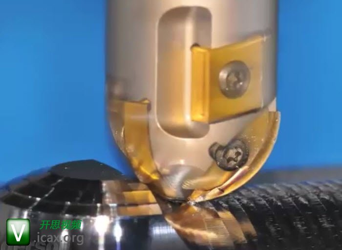

Ingersoll Pro-Trio Ball Nose Steel Z-Axis
Material: 4140 Steel
Tool: 2TW7K-1203781R01
Insert: NCEU 320500R & NCEU 320500R-P
Machine Type: Cat 50
Grade: IN2505
DOC: .200 , WOC: .100
RPM: 1458, SFM: 477, IPM: 56
