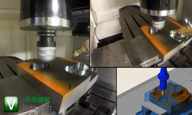

[加工视频] ESPRIT ProfitMilling on a Mazak
Material - 4140 Steel (Pre-Hardened), 30 HRC
Cutting Tool - 1/2 inch carbide, 6-flute endmill
Feedrate - 360 ipm
Cutting Speed - 1,309 sfm
Spindle Speed - 10,000 rpm
Engagement Angle - 30%
Depth of Cut - 1.00 inch
