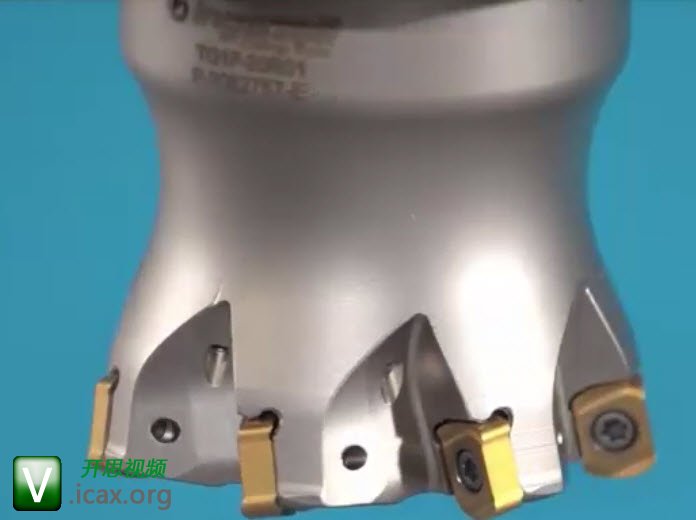

Ingersoll Hi-Feed Mini 304钢加工
查看数: 18249 | 评论数: 0 | 收藏 0
发布时间: 2013-4-21 18:19
Material: 304 Steel Tool: TG1F-20R01 Insert: UNLU0603M0TR-ML Machine Type: Cat 50 Grade: IN2505 DOC: .025 , WOC: 1.3 RPM: 955, SFM: 500, IPM: 110
